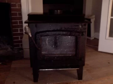

I recently talked a friend into buying a stove from Craig's list. Thanks to everybody's help we identified it as a Century CDW 244, or maybe an early version of that stove.
(broken link removed)
Now, I'm having trouble getting it to burn.
I installed it in her fireplace. I put 14 feet of 6 inch single wall pipe on it and I can't get it to draft.
When we picked it up I took the firebrick out. I thought they all were the same size but apparently not. Now I can't get them back in correctly. I also can't find a diagram online. I think I may have covered up the primary air intake with a brick.
Could someone please post a picture of how the brick are supposed to go in the stove?
Also, could you please tell me where the primary air is on the stove? On my Summit there are holes in the bottom front of the fire box. On this stove I dont see any. Also where the does the air enter the stove? This stove sat in an out building for a few years before we bought it and I'm afraid there might be some sort of nest clogging the intake up and I would like to inspect it and clean it out if possible.
Lastly, is 14 feet enough liner for this stove or should I add a few feet. I'm still not to the top of her chimney yet. I'm pretty close and I do plan to run it to the top and put a cover plate over the chimney, but right now I just want to see if this thing will burn correctly.

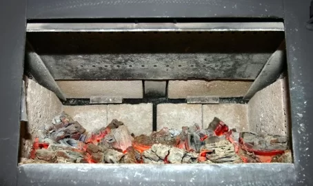

Mine's neither of the models you guys are talking about, but I'm quite sure there are no passages in mine for primary air to travel down from the top entrance and enter the firebox from the bottom...it all enters as airwash, but once a good draft is established, you'd swear there was primary air entering from directly along the lower front, just from the behavior of the burn. My stove's in the final stage of burning my last load of the night...coals to ash now...so I just now opened the door and took a pic of the brick the way it's installed in mine. Your stove may be different, dunno. Rick

Thanks for the picture Fossil. The firebox on this stove is different. Your two top fire brick are exposed. This firebox has metal going all the way to the back. I guess you're lucky. You can clean your chimney without removing the stove. That isn't going to happen on this one unless I can make some sort of shop vac attachemnt to go above the baffel and suck the powder out once it is brushed from the chimney.
