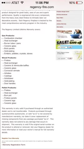

I believe regency has a lifetime baffle replacement warranty. You might wanna check your manual or call your local regency dealer.

No i don't think they have a unconditional life time baffle warrantee
Ceramic baffle right? You might be in luck. I had an i1200 and was able to replace mine twice free of charge.

And in the manual it says it isn't covered if it is over fired or abused . How old is the stove tumm? You might get it replaced if it is cracked and not burnt out
Regency never ask me for the old ones or proof that I didn't over fire. Give it a shot...if you are the original owner it's never a waste to ask.
We have replaced a few under warrantee regency usually asks for a pic and what we think. If it looks like a stress crack from a defect i am sure they will replace it if it looks like you dropped it probably not.
Like the OP indicated. As he was sliding out the baffle....he noticed it crack. I'd say your under warranty. Good luck!
