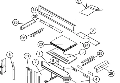

This is on the Summit B and C models. It's number 26 on the parts diagram. The feed tube hole in the diagram appears to be similar but the gasket looks to be full width of the baffle.

Parts diagram posted if from the C model. Does this match your "B"?
Reactions: Squisher
Yeap, #26

T series all take the rectangular gasket according to my manual.
Edit: doesn't make sense T4=series "C", T5=series "D", T6=series "A" according to the Labels.
They all use the small rectangular gasket according to my 2007 manual.
Interesting my summit is a 2015 b series and I thought my gasket was the smaller rectangle one that just fit over the secondary feed air tube. I felt certain it was atleast and that's what I replaced it with when I cleaned it at the end of It's first season, and when I pulled the baffle off I messed up the old one. But now I'll have to look closer this year and see if I can find any evidence of it? And replace it with the proper one I suppose too? I'll compare it to my older super too. I wonder what the difference is? Helps to support the baffle equally all the way across the back ensuring it sits more square on the secondary feed tube possibly?
