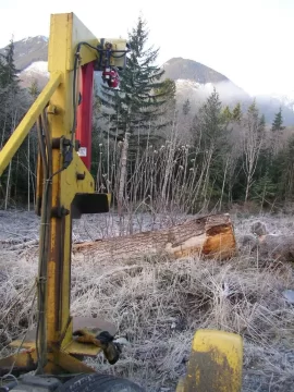

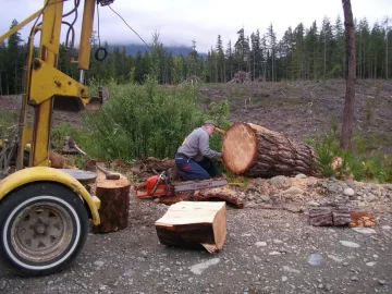

Much of the wood that I cut is roadside waste with lots of sand and dirt on the logs. If the log has lots of dirt or sand on it, I will roll the log using the winch on the splitter to get a clean face to buck down, taking all of the cuts 80% through and will again roll the log so the sand is on the top. I then will complete each cut cutting up using the top of the bar cutting from the far side of the cut first. This throws the sand away from the cut. Downward cutting through sand or dirt pulls the dirt into the cut .
I like to file to equal heights.
On the rakers I like to leave them as high as possible so there is less chance of a kick back. I watch the chips that a sharp chain is making - big chips means the rakers are fine. When chips are becoming smaller, it is time to take the rakers down just a bit!

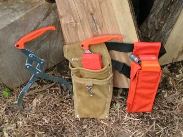

I used to carry 2 wedges,file/handle & scrench in back pockets but this goes in the field with me every time now.Quick release nylon belt,room for extra chain and/or tape measure if needed.

No-no Thistle, your doing it all wrong. If you don't have to fumble and hunt for that stuff....it just ain't right.:)
See,I'm finally getting smarter in my advanced age. I 'got by' for yrs wasting time looking for stuff,not having proper gear & it made both working in the woods & my regular construction gig a 'job' & more effort instead of FUN like its turning into.
Now am slowly going for the 'work smarter,not harder' mantra. If only I could win LOTTO then I'd write out a check for that Cat 65HP skidsteer w/rubber tracks,grapple bucket & extra winch.Then I'd REALLY be happy.... ::-)
