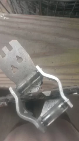

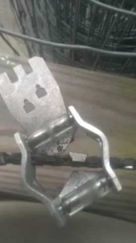

I bought the husky sharpening set and sharpened up my two chains today. I like it its easy to use and set up to be pretty much a no brainer kind of thing. The one chain was quick and easy the other was a little bit harder as it was pretty worn out but I got it, and of course I included some pics they are before and after.
Not bad! But how does it cut?
