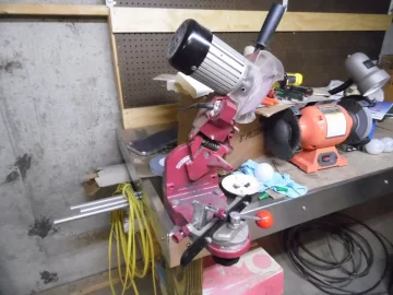

I got one of those chain sharpeners from Northern Tool, I think it was. I have pretty much figured out how to use it, but I don't think I'm getting the best results I could be. It seems the chains could stay sharp for longer than they do. One of the biggest issues I see happening is that no matter how I do it, the thing burns the tips of the cutters. Fast pass, slow pass, very shallow cut, etc., nothing seems to change that. So what, are you supposed to spay some sort of coolant on it?

I'm wondering if you are taking too much material off at each sharpening. It should just be kissing the cutter.
Also, you are using a depth gauge and keeping the rakers down (25 thousands I believe is standard) right?
No, and not really. But I do know that I should be paying better attention to the rakers. It seems that no matter how small a cut I take, the teeth blue.
Also, I have noticed that the left and right teeth seem to be off in length. The LH teeth are one size, and the RH teeth are a different size. Not sure why this is, if I start with a new chain, and set the depth of cut when I start, and do the whole chain, L & R with that depth of cut.
It takes a light touch to keep from bluing the cutters.I have a Silvey 600 and never blued any cutters.
You will have to do a bunch of adjustments and refining to get your grinder to work properly.It's a cheap grinder,but can be made to do a good job.What color wheel?Some are better than others.Just light taps with the wheel on chain,if it's blued already nothing you can do to put the temper back in the tooth.
Thomas
I'm also wondering what type of chain this is. Maybe an extremely hard steel?
The chain is Oregon, I believe. The wheel is the pink colored one that came with the grinder. Salecker, using a "light touch" how long does it take to sharpen your chain? How long is the chain? I have also noticed that in the past, when I used to have chains sharpened at the local shop, they never seemed to come back blued. If I'm not mistaken, most of the shops use basically the same tool I have, just a much better version of it, no? And, when done, do you guys clean the chain with anything?
You need to very lightly hit the cutter several times which allows the cutter to cool.
I made a bushing to use worn out Silvey wheels on mine. The pink wheels are real hard. The charcoal grey wheels are much softer and run much cooler.
The 2 types of wheel I found were resinoid, and vitrified. Which one are you referring to?

Seems like some of my problem is the machine. The instructions were lacking, to say the least. I knew this before I bought it. Like I say, my biggest problem is bluing the teeth. I get that's bad. I'm just not sure how to make that not happen. I have some chains to sharpen today, I will try taking off a very small amount & going slowly, and see if that works.

The wheel needs to be correctly profiled, the it should match the cutter face exactly the same way as a file does. That means 20% of the wheel or file needs to be above the cutter. If you go to deep into the gullet you are grinding with the side of the wheel rather than the radiused edge. When you clean out gullets you go deeper and DO NOT hit the cutting edge.
