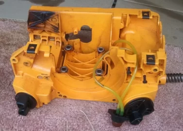

Here is the fuel line routing for most 42cc Poulans.
Tiny .08" line has fuel pickup on it inside tank. The other end goes on carb fuel supply line which is normally on clutch side.
Medium 3/32" line goes from long/fat purge bulb connector to tank hole near clutch. Short/thin purge connector goes to carb tube on flywheel side.
