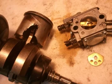

The model # would help. If saw is 1990s and newer, the idle screw is a phillips with taper on the end. It sits apart from H-L screws, either above or below. See the lone screw above the H-L screws in this pic.
[Hearth.com] Chainsaw bogs down no power
