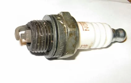

Well, I replaced the plug, and now it runs fine.
Here's the old plug. Does it look fouled to you?
