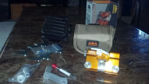

The Timberline came in today. Along with a couple things for the 460...
Talk about Fast Shipping....
Hope to get time later to try it. Son was up sick last night. We both stayed home. Gotta take care of him 1st.

You LUCKY BUGGER!! Keep us posted on how it works. And I hope your boy feels better soon. My whole household has a bad cold too!
