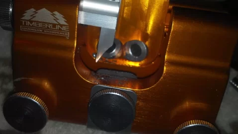

    I've done 2 chains so far this morning. Taken me longer than expected. After doing it a few more times, I'm sure it will get easier. One thing is for sure. That carbide cutter will remove material in very short order. I did a chain on my Husky that had found an old Eye Bolt. Cutters were pretty bad. Took about 10 minutes to do the entire chain, but took me 10 minutes to get it properly set-up. There is only 8 steps to get it set-up. But they must be done precisely and properly.
    The second chain was a little faster. Definitely an value added product to an arsenal. IMO. I also bought the 25° & 35° angle inserts. Have yet to try them. But for what they cost, the discount basically paid for them. 2012-04-09_15-31-10_743.jpg

    I did a chain w/ the 35° angle dies and it flew through the wood. Large chips.. Very Large Chips... But it did take me 2 times to get the cutter to take the 35° angle. Maybe it can be done in one pass. But it felt like to much being takin off. So I did it in 2 steps. Half on the 1st round and the next half on the 2nd. 2012-04-09_16-40-52_102.jpg 2012-04-09_16-41-09_928.jpg
    Is one better than the other?? Prob not. I am not the best hand filer. I will admit that. I have only been self sharpening for a lil over a year. So this is my way of getting a very good edge on the 1st try. I still intend to hone my hand filing. But until then, this definitely does the trick.
