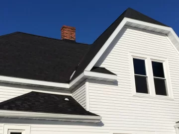

It may not look too intimidating but the angle is pretty severe, especially for someone who dislikes heights. Obviously a flex chimney liner looks better to me because I can rent a lift and just put it down there, but what are some strategies for dealing with 20+ feet of rigid liner where I would probably have to rent a lift to get up near the chimney, or fasten some rock climbing gear together to make it safe to be up there. Any thoughts? or am i missing something obvious...

I have a JLG 40 ft boom lift , that I used to build my log home . The feeling of security in the basket about 40 ft off the ground is comforting to say the least. No way would I be on a ladder or roped in with climbing gear. Rent the lift , it will be faster and way safer.
I wouldn't use rigid i would definitely go with flex. I find rigid to be a real pain in the ass. If you don't like heights get a lift we wouldn't for that job but a roof is no where for someone that is not comfortable with heights. Actually id rather be on a roof than a lift many times i have found that swaying lifts bother me way more that a step roof. But in your case go with flex (preferably heavy wall flex insulated) and a lift.
I rented a lift to do our liner, and fed the liner up from the bottom. Chimney liner depot gave me the "puller" that goes on the end of the liner. A couple good knots and maybe 10 minutes of work and the liner was up and in.
You could scaffold that roof pretty easy....you have that nice lower section for an added feeling of security...then you just run the valley, not a bad roof.....no comment on the different liner options...not my area of expertise....
I installed double wall insulated rigid by myself, and had no major issues.
I have also installed flex for others.
Personally, the rigid is much easier to install than wrestling with a long pc of flex, and a sturdier and easier to clean liner.
Rent the lift, and get it done.
I did mine from a ladder against the old chimney masonry. Same way I clean it every year.
You could also build a platform next to the chimney to stand on and work off of.

My vote is for rigid also. I used oval duraliner insulated rigid pipe for mine. Flex liner would have snagged and cocked halfway down unless you pull it with a nose cone. Solid you can push, lift, adjust and push again if it snags. I used a 36" section of flex at the bottom of mine to clear the damper section and with the oval liner it passed right through without needing any cutting or modification. Best thing about the rigid for me is you can carry 48" long sections up to the roof at a time rather than the entire thing. It rivets together and you lower it down as you go.

If it's a straight shot, I would go rigid. I found it easier to manipulate the short sections of rigid than wrestle a 25' stainless steel liner "flex" liner. It's called flex, but I can assure you it does not flex easily. With the rigid you lower one piece down, use a pop rivet gun to attach the next piece, lower that down, and repeat. It gets heavy towards the end but you can put the metal clamp/bracket on there to hold the weight while you attach the next section.
AS a pro i will probably never install another rigid liner i find them to be a real pain in the ass and i honestly don't know of any other pros that use them much at all anymore. The last one we did the customer insisted they needed to have rigid. The chimney looked pretty straight well we got it 3/4 of the way down and it was not straight. WE gave them the option of flex or cut a hole in the outside of the chimney to remove the offset edges of the brick. WE ended up yanking it out and coming back with flex. So make sure your chimney is truly straight enough. As long as the install is done well the rigid will last a long time though. If you do go with rigid absolutely go with the pre insulated stuff though insulating each piece and the taping the insulation together as you assemble them is not fun

I look at roofs like that anymore, and realize I'd rather pay someone to go up there, than do it myself. Mostly because I enjoy being not paralyzed.
I have had three liners installed in different chimneys on this house, by the same sweep. I could have done two of them easily enough, by myself, but resolved to stop doing roof and chimney work when I had kids. I felt justified in this new resolution of mine, when my sweep told me he lost a lot of sleep thinking about going up on my roof for the last install.
