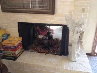

I have an L shaped fireplace I have never used. My dad said it would suck up as much heat as it produced. (dad passed away, so now I can't ask him what to do) Can I install a stove or does it have to be an insert? Size of current fireplace is 24" H, 37" W, 25" D.

I suspect you will have to install an insert. But you can leave the sides open, with no surround. Take a look at stoves that can be installed as inserts or freestanding like the Avalon Rainier and most Buck stoves.
How much space are you heating? Are you heating part time or do you plan on heating 24/7? What is your floor plan like? The Kuma Ashwood could also be considered in your case.
I have a 2000 ft ranch. I want to be prepared for a disaster. I remember when Sandy hit the east coast. People with propane heaters waited in line for hours trying to get fuel. So being prepared for a blizzard & going off grid is my priority but of course if we could use enough for it to pay for itself that would be ideal. (I tried to include pic, ignore the mirror, candles etc in fireplace. Obviously we have considered it merely decorative)
