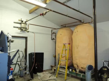

I had the same chattering when i had some air in the system too.My pressure is running right up against the 30psi as well.I dropped the pre charge pressure in my expansion tanks a little to get more room in the expansion tanks.But the first time i maxed out my temps this yr i did blow out some water from the relief valve.I added a little tank that came with my boiler hoping it would up my expansion volume to handle higher temps.
I added a pic,you can see the double check valves on left side of the tanks.A few people have asked what it was and i just said i was told to build and install it.Sometimes i look at it and wonder if it was just a way to sell more fittings:rolleyes:. [Hearth.com] Chattering heat trap check valves
I'm pretty curious on exactly what those two check valves would do for things? Don't think I've seen anything like that in piping diagrams I've seen.
That twin check-valve, heat-trap arrangement has been the standard piping recommendation from the company that has been selling Tarm boilers for decades. It works. It keeps heat from migrating out of storage when not called-for.
