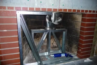

I closed up mine using steel studding that is masonry screwed into the mortar between bricks and firebricks. I added kaowool insulation between the studs, then sealed off with durock. Pic below was from early in the close off process - ignore the steel structure in the back that is supporting the liner

Question - how to you access the tee behind the permanent wall structure?
Sweep top down, access stove pipe and tee from top of stove - the F500 has an oval cookplate area that floats on the stove top. I was originally going to have to move the stove to access it all, but I think I'll be fine with this method.

Not the topic of the original thread, but I have a question.
I note the "waiting for inspector" part of your signature - wondering if he will have a concern about the removable bottom of the tee being behind the finished wall. May be late to need, but would a solid 90* elbow with some downslope on the pipe to the stove be better?
I am genuinely not sure, so I ask the question.
I'll be able to access the 3" or so below the pipe with the vacuum hose, so I don't think that it matters either way - I also rationalize this with the fact that a tee 6 ft up a chimney cannot be accessed from the bottom without a clean out door anyway - maybe to keep on the original post - ask me anything else over here:
