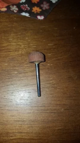

Doug, I also have a Quad AE and have often wondered about using a Dreml to clean the fireprot. What attachment did you use? Sandpaper, rotary stone, rasp,etc. Sometimes there are some really crusty deposits that I battle with a screwdriver to remove. BRAVO for having the courage to use a Dreml. Any comments/suggestions would be appreciated. Thank you.

I just used a small grinding wheel. I also removed the firepot, make getting to the floor a bit easier. That being said....

I took the firepot out today. I missed a bunch of carbon last I cleaned it. Prior to the start of this I had never cleaned the floor of the pot. Stove had about 25 tons of pellets thru it prior to having a problem. In the future I will be cleaning the floor prior to first fire of the new season. This is the bit I used in the dremel to clean it...
