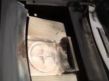

Excuse the mess, I was waiting to clean this Fall, but just now noticed the rust deposits. I have read posts where people use damp rid, etc... now I know what your talking about! This does not happen with my Jotul.
[Hearth.com] Check out the rust...
My game plan is to fire it up to dry it out and wire brush. I was somewhat surprised to see any rust. I will definitely prep the stove for next summer.
Looks to be surface rust. Burn it hot initially. I plug my exhaust and intake ports. And after a full cleaning I will spray paint the removable baffle and spray Pam cooking oil all over the inside. Put the baffle back in and place a small bucket of damprid. I still get tiny specs of surface rust, but it cooks off with the first burn. No additional smoke from the oil either.
Thanks for the replies/advice. Just a bit surprised for such a new stove. I have burned 74.5 bags. And as I said, I never had this issue with the Jotul, I've read the posts on the subject/prep...now I really know!
My father-in-law's Harman coal stove rusted too. It has everything to do with moisture coming back in through the direct vent. Some folks actually leave kitty litter in the ash pan to absorb moisture! Plugging up the OAK and exhaust are a MUST.

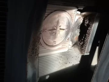

[Hearth.com] Check out the rust... Attached is another before pic. Here's what I'm gong to do...
Get a fine wire brush wheel for my bench grinder and hit the medalian and 2 back plates. Of the outer pitted frame, sand with 400 or something to smooth out and etch. Then I can cover all with high temp spray paint. Question, is the dealer supplied touch up paint not sufficient for heat (most likely not). So I'm thinking header pipe spray from auto parts or some other suggested paint. Also too, should I use acetone after sanding the frame?
Thanks for replies...
Search the name Don 2222. He has several posts on paints to use - acetone after you sand/wire brush. He refurbishes old stoves on a regular basis. He recommends the VHT head paint flat black. Directions on curing the paint are on the can and posted above.
