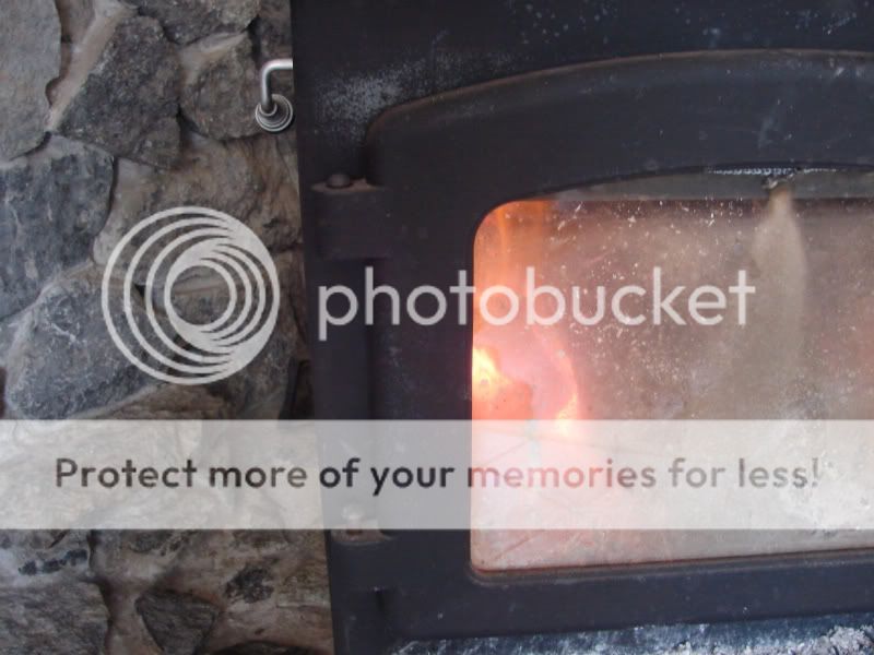

just opened and closed the door a dozen times and its already started to come back up..
it doesnt turn when i close the door but turns when opening? the top one turns both ways..

It is the lifting up as you open and close it that does it. My old stove did the same thing for 25 years and the 30 does too. It is natural to lift up a little bit when you open and close it. And mine have always done it most on the bottom pin. Which makes sense leverage wise.
Coating the pins with a little graphite will slow it down.
took it out and let cool then sandpapered added a little lube and seems better now bart ;-)
but will keep a better eye on it for sure.. thanks eh

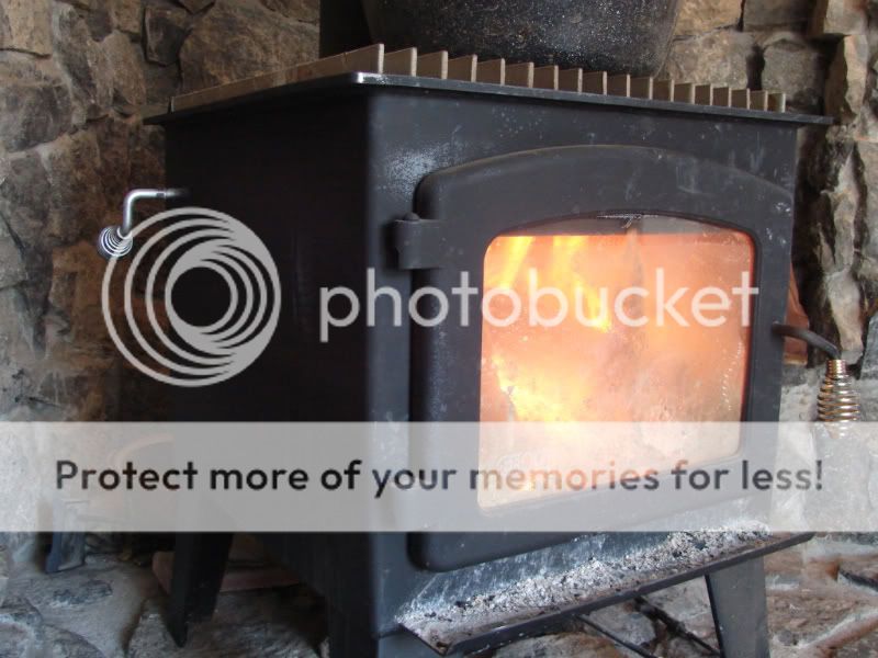

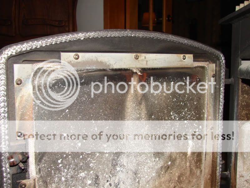

What is that handle on the left side of your stove loon? And when are gonna fix that sagging gasket/air leak at the top of the door glass?
EatenByLimestone said:
maybe it's used to engage the cat?
Matt
Ah. Maybe he has the 30-C. :smirk:
BrotherBart said:
loon
If it's one of Drolet's bigger stoves, it's probably the baffle by-pass. It lets the smoke go straight up when you re-load.

your right jim...
and the gaskets on the door are gonna be replaced right after this years burning season :cheese:
i promise ;-) pictures to follow :)
