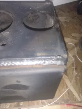

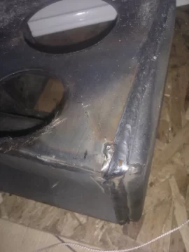

Just picked up my first pellet stove and been using it in the evenings lately to keep from burning oil. I noticed that within a few hours the glass was black, alot of ash, and the flame seemed lazy. I started cleaning the stove tonight (gone through 8 bags of Energex) and removed the burn pot to find these two globs of weld, which was keeping the burn pot from getting a good seal and vacuum blowing up by insteadof through the plate. Holy what a difference now, the plate is now covered with glowing coals instead of ash.
Check your burn pots guys, and you will prob need a new gasket as I do. I'm also sending this in to englander so they will enforce their QC checks.

Stove has been running 10 hours now, just a thin layer of grey on glass, not black like it was and burn pot is not full of ash either. Also I just checked the hopper, normally I'd have to fill it up at this time each morning and it has only used half that amount.
I ground down the globs of weld so the burn pot sits flush with the gasket so it is sealed now instead of air leaking by. The air is now flowing up through the burn plate instead of out the back side of the pot.
