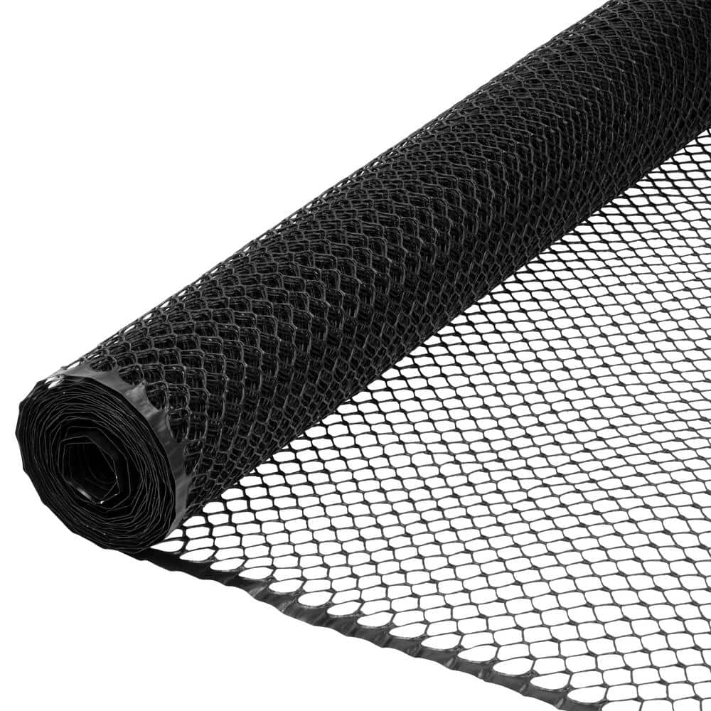

Zip tie some bird netting? maybe not super strong but maybe enough for a couple years till the kids get bigger.

True. I'm kind of liking the bird netting idea. Not quite as effective a deterrent as shocking but maybe painful enough to dissuade further attempts.
Reactions: stoveliker
Yes, I agree. Netting that has a mesh size that does not allow for child-feet to step into them (and is tightly enough suspended so it won't fold over the cables, effectively allowing to step on the cables) might work.
That is more or less the same as the cloth Rusty proposed. - but it allows to see through, which is the nice part of being on a deck (vs in a room) imo.
Painful ? What is this bird netting exactly ? Can you provide a link ?
I used something like this but is was square and probably heavier than this. But it was cheap. Zip tie to cables. It’s not the prettiest…..

Is there a reason that you guy think the plastic options would be better than the hardware cloth, or just a bit cheaper /
very light duty
i posted link to amazon but not showing it
just google bird netting or garden netting.
(broken link removed)
Cheaper, easier, less obtrusive.
I had plastic up for 8 years. Was as good as the day I put it up. Funny thing is I plan on installing steel wires
