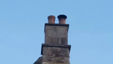

Hiya. Pics. Chimney with cap the one being used.

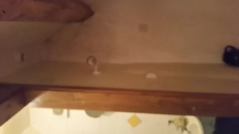

Attic pic. Wall wirh beam behind which are chimneys. Extractor fan on wall on left of pic.

It may be smoke coming in the fan but the smell you are describing is not wood smoke i say you need another sweep to do a full inspection. Was the liner insulated? was the chimney scanned before lining it?
I don't know to either of those questions. It's disappointing as he's a HETAS registered guy. Anyway will get someone else in. Thanks
