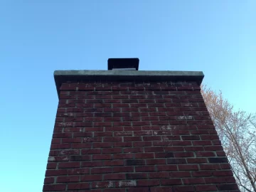

Here's $4400 worth...2 summers ago (3 flu). Connected now to a pellet stove pipe so I guess it counts in this thread...

Here's the skinny on masonry chimneys, inspect yearly for cracks or any sign of moisture damage, moisture once inside a crack will cause larger cracks and deeper cracks during the freeze thaw cycle. I will be redoing my skim coat this summer on my boiler chimney, im starting to get cracks near the top part by my cap.
Maintain it and take care of any small issues when they come up and a total rebuild wont be necessary. The main thing if keep the water out and dont do it with sealers either they are just a bandaid
Many of the chimneys around here that are falling apart is due to poor design. For some reason the mason decided to step the brick out at the top to create a "bell", which is fine. The problem is they step the brick back in at the top, that creates a place for water to enter the mortar joint. They also use mortar for the crown instead of cement. It's all down hill from there! I see it all the time around here.
Mine was also like that. I had to tuck point most of the backside of the chimney, then I cast a new crown in place with cement. The overhang prevents water from running down the bricks.

Boy, just like OAK or no OAK, brick sealant is a topic for discussion.... I had it done, but the real problem I had (pic above) was a porous brick that cracked from the inside. Also too, the orig chimney builder filled around the clay tile with about 50 mud buckets full of sand and small rock. My masonry guy had never seen anything like it. Still talks about it to this day.
Sounds like a much better idea than backfilling it with mortar which is more common.
Your brick was cracking from the inside because water was able to find its way through the crown and then froze and busted.
Reactions: bholler
I have seen it to it is a pain but like webby said not really that bad it still allows for expansion and contraction unlike mortar which i see allot more. And pretty much everything else he said was spot on as well
Yes, all agreed. Cracked crown, internal sand held, retained moisture, expanded, then cracked and popped the brick. Was suppose to be a fairly simple repair but turned into a total rebuild once ripped apart and saw the damage.
