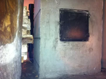

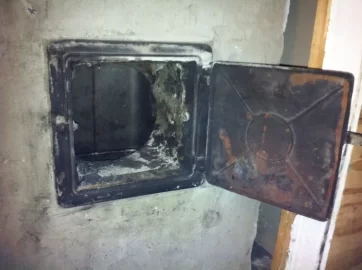

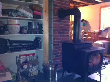

Thought it might help if I show photos. Pardon the poor quality:

I'm not understanding where my Tee-cap is located. When my home inspector did his walk through, I was right by his side, and he opened the clean-out door, and took a picture right up the chimney saying that he was impressed with how it looked. He never mentioned anything about having any additional Tee. While I understand the inspector could have overlooked something, or maybe didn't know about it all together, my sense is that he was ridiculously critical of everything in the house - the stove or chimney wasn't anything he flagged other than to say have it cleaned every year by a qualified professional.
Further thoughts?
The inspector should not have been able to see up the liner from the clean out door. The liner is to be a closed system, with a plug at the bottom of the tee. . To clean it, you remove the plug and sweep, remove the waste and replace the plug. Otherwise the flue draws from outside air instead of from inside the stove. Hope that helps.

We're guessing there is no cap on the bottom of the tee and instead it is open. If so, it may not be ideal, but this is not a rare setup. It does require the cleanout door to seal tightly with a gasket. Ideally when they put in the liner they would have added an extension on the bottom of the tee to just the top of the chimney cleanout door, then capped it there. But my guess is they didn't to save you the extra cost and be competitive. on the bid.
does it even have a tee? maybe they just bent the liner and the stove connects directly to it. I see this quite a lot with water heaters.
You are correct, it is open at the end of the Tee. I'm positive there IS Tee as when I installed the thimble for my Lopi I noticed that it connected to a section of pipe separate from the liner. Unfortunately, this work was done before many years before we bought the house last year. I know the former owner was very much a DIY'er and tried to save money everywhere, the neighbors still talk about him being a bit "cheep" so it doesn't surprise me that he took the cheep way out.
