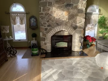

My concern is that prior to installing a stainless steel liner and fireplace insert there was a certain coating of creosote on the original clay liner from years of conventual fireplace burning. Now when the fireplace insert is in use, high temperatures from the stainless steel liner will gasify the creosote from the surrounding clay liner and will have no place to escape to the outside since there is a stainless steel cap plate at the top of the chimney. Therefore, creosote gasses may be leaching into the interior of the house.
It's a valid concern. This is why it is imperative that a chimney be fully cleaned before putting in a liner. This includes not only the flue tiles but also the smokeshelf and damper area. It's also part of why insulating the liner is required. If this work was not done before the liner went in, then it should be pulled and done properly before reinstalling.
Thanks for the response. I have a geothermal system in place but being in a rural area near Allenton PA I enjoy the ambiance/warmth of the fireplace insert during the winter months. I do have an AWAIR air monitor that seems to be extremely sensitive i.e., someone walks into my house with perfume or hair products it will spike the VOC readings but when burning the insert, it shows nothing, PARTICULATE or CO2 readings or smell either. Yet after about 48 hours of burn I feel respiratory irritation, foggy and lethargic. This summer I could pull the liner and clean the flue tiles but is it realistic to expect complete removal of creosote? I’m sure it’s typical but I noticed the mortar joints between the flue tiles were not pointed and protrude approximately ¼”. I could add blanket insulation to the liner, but would it be better to use a vermiculite mix to help seal? Originally there was a Heatilator but I cut out the steel flue and smoke shelf so it would not interfere with the liner. I did not add a block-off plate or blanket insulation into the opening which I could also do. It seems impossible to find quality work these days and usually end up doing everything myself.
