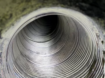

I cleaned it at the end of last year. My wood is blow 20% except for a little maple that might have been 22-25ish. Im a welder by trade and they allways pound have a fire extinguisher handy in you head i guess it kinda stuck lol. Heres some pics or it now [Hearth.com] Chimney fire help

Ok. I can't judge the liner pics. (Looks clean - but I assume this was after the cleaning).

Sorry i just realized the photos are videos with weird music. Anyways thts the veiw from the bottom up the liner is only 2 years old soni hope it can be saved. I checked the liner temp just off the back of stove and i keep it around 300 it was at 700 thats how i knew something was wrong. The sand is a good idea. I know water on hot steel is a no no but i panicked. What dose a big flue fore look like? I saw sparks and it sounded like a fan was blowing on low but i never saw flames.
