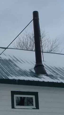

Btw the DW 1500 is not a cast iron stove but plate steel stove Please post a picture of your setup and take a picture outside of it exiting the roof.

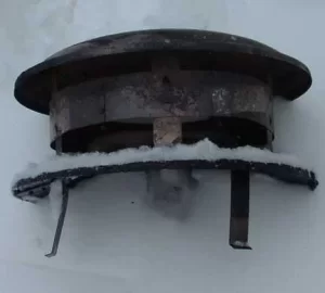

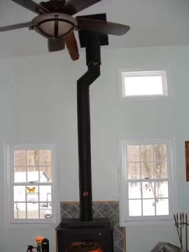

Here's some pictures. I have my chimney cap off until I have my stove man comes out and see what the problem might be. I can't get the fire hot. He's going to come out clean it out. Check it out, check out my wood, etc. He said something could be plugged up. I did burn some wet (from the rain) wood early in the season before I covered my wood. Again thanks so much. I'm really afraid of having another chimney fire. I've spent all my savings fixing up an old farm house. Two years of hard work and I love my home.
I've been doing allot of reading about safe burning. I did notice that before the fire that every time I opened the stove it smelled bad and smoke came out. I don't have that problem any more. I quess its a warning sign. I check my chimney and I don't see smoke coming from it. Also the seal on the door isn't really really tight so he's going to tighten that up.

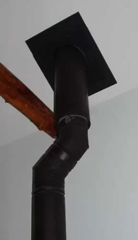

Elk is right. The gases are cooling down and collecting at the 45. Can he change it at the stove and go straight up through the roof. Bob
every change in direction of your exhanust patr produces friction and stalls the natural upward movement. exhaust the is slowed down will cool and deposit creosote. as it cools it also looses monentum to continue accent. In your case you have 2 45 drgree elbows the frictional effect is like adding an additional 5' to you connector run It may be 8"6 but effectively it is 13"6" far beyong the maxium for single wall connector pipe as per manufacture specs. this additional length is causing your condition and the reason the fire dept was already there IT is not code compliant.
I know the original installation was done before you bought the home but it was wrong then and the fire dept trip proved that. that length of connector pipe requires it to be double wall pipe.
the double wall pipe will hold in the heat better which will promote your draft. your stove will run like it should. It will run hotter and reduce creosote in the first place.
Double wall connector pipe is not cheap probably why the original owner did not install it. But that's what is required. More important you now realize it is a safety issue.

Hey guy's and gals chime in here, but I think the single wall pipe is connected to double wall connector pipe up and out the roof? I fear it may not be class A chimney pipe?
Caught my eye too Elk. It's not too common to see black class A pipe. If true, I'm surprised the fire dept. didn't point this out. Also, no rear hear shielding on the single-wall.
bcinny, if you take a tape measure, how far is it from the rear edge of the pipe coming out of the stove to the wall behind it?
Many fire fighter do not study code and are vollenterers. BE green you may be on to something I think there may be clearance issues with the pipe and the stove the tile on the wall does not appeat to have the 1" reduced enclosure air space ant then the distance to the wood window moldings? then as you said the single wall pipe clearance looks suspect.
I think you need expert advice and not from a vollenteer fire man. Can you measure your didtances from the pipt to the wall and also measure the distance from the stove to the window moldings? Can you tak a picture on the side of the stove so we can see the spacing relationship to the wall and see if a rear heat shield is present?
You had this stove professionally installed did you pull a permit? Who inspected it I would love to see the original bill of sale to see what materials they charge you for? that would provide clues as to the maTERIALS USED IN THE INSTALLATION.

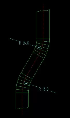

I cringe every time I see sharp cornered elbows like that.
Why not or do stove pipe companies make elbows with nice large sweeping radiuses?
If that were my setup I would get a length of 6" 10 gage wall (~0.134) steel tube.
Cut a bunch of pie shaped sections rotate them around and weld them back together to make an nice smooth S curve with about 16" radius to the center of the pipe.
Sand the inside of the welds so there are no rough areas to slow up the smoke.
What would code say about that?

I just had this stove put in this past Sept. I paid $1000 for the stove and $1000 for the chimney plus installation. I also had a couple propane heaters put in. Total cost over $6000. The company that installed it seems really good and wants to help solve this problem.
The stove is my primary source for heat. The angle is there to go around a beam. The single line chimney goes into a double lined chimney about 2 feet from the ceiling. The flames were coming out of that space and out the top of the chimney on the roof.

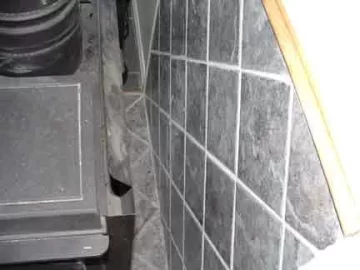

Here's the picture of the back of the stove. It's 8 inches clearance from the back of the stove to the wall. But it has another wall on the back of the stove. I took care of the back of the stove and floor. It has the cement board under the ceremic tile.

If the stove is too close to the wall I have room to move it and have more clearance.

So who's gonna call this one? It looks like single wall pipe is about 12" from the wall. bc can you confirm? Also what is the exact make and model of the stove? If it's not on your receipt it should be on the manual and there should be a plate on the back of the stove. While back there, can you tell if the stove has a rear heat shield?
I hate to say it, but so far this appears to be an illegal installation. But don't panic, we'll need some actual measurements, stove make and model, etc.. It's hard to tell from the pictures and I could be mistaken. Does your receipt list the piping model and type for the stove? If yes, please post that as well.

I too would agree from these pics that the stove/pipe is too close to combustibles. My other concern would be why did she have flames coming out from the connection to the chimney or double wall(whichever it is)? Seems to me that with a chimney fire anything in that area should have been being pulled into the pipe and up the chimney. I would be very concerned.
