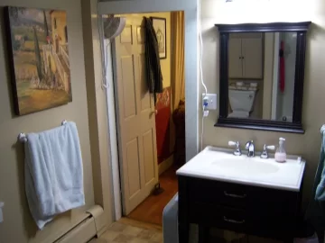

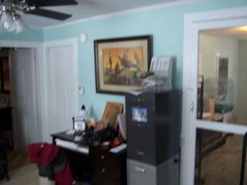

The 1st pic is pointing east it's the bathroom doorway,there is a fan in this room aiming into the stove room on floor.The closed door is the cellar.In the bathroom is a door way fan up in the corner of the frame pointing south into the living room.The living room then hooks to the small hallway on the right are the stairs to upper level and the rooms upstairs actually sit up over the stove room and bathroom.At the top of these stairs we keep the doors closed,we want the bedrooms cool.Downstairs coming from the living room into this small hallway with the stairs on your right,straight ahead is into the bird room,both ends of this room (which points west) has a screen door.After walking through the bird room this last door leads back into the stove room.This door way and the hall doorways have no fans.The air moves fine here.

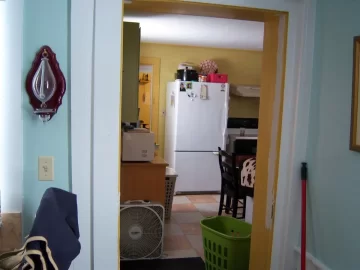

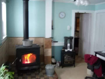

This is the 3rd doorway leading from the stove room into the kitchen and an add on puter room which points north.Both rooms are about 15' by 20'.The kitchen has a box fan on the floor aiming along the floor into the stove room.Air flow is good with this fan also.The pic on the right is in the bathroom looking into the living room.The fan on the floor under the sink and the doorway fan.

So If I understand this correctly, there are 3 open doors, and the closed basement doors?
With 2 doorways with fans in them blowing into the stove room?
You may want to try a few things.
Have one fan blowing into the stove room, and the other pulling out of the stove room. Also may want to try closing one of the 3 doors also. Yes you may have air flowing all over. But you want to create a loop, where the air will flow in a continuous loop. 2 fans blowing into same area would in my thinking create a lot of turbulence, but not really a loop as they are working against each other, rather than creating a continuous loop flow.
If you have not experimented with this already, give it a try.
