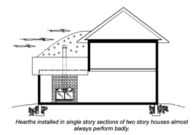

I have a question similar to @nhwoods, where I have a 1 1/2 story main residence with a gas fireplace and chimney above highest point AND a 1 story addition with a gas fireplace and chimney above highest point of the addition’s ridge. The termination point of the addition chimney is lower than the main house but a good 30’+ horizontally separated from each other.
My main fireplace performs fine, however, the addition fireplace suffers from backdraft. I have closed the damper in the main chimney but the backdraft continues.
Both chimneys are clean and clear.
Can the additional indoor living space of the 1/2 story in the main house still act as a draw on the lower chimney height, even though it being outside?
To match the elevation of the main house chimney, the addition chimney would need to be extended about 4’ higher. It might appear odd but is this what I need to do to correct this situation?

Is the addition's chimney on the outside of the wall or fully contained in the structure? Exterior chimneys are prone to draft reversal when cold.
There are several possible causes, some are easy to test and isolate, some are not. There could be negative pressure in the room. Does the backdraft stop if a nearby window in the room is open an inch?
One story additions often suffer negative pressure due to the chimney effect of the taller main house. If there is a window open on the upper floor of the main house, or an attic door that is not sealed, then it can create a vacuum effect in the rooms below. It can also happen if the lower chimney top is in a positive pressure zone.
