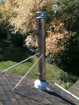

Here is my chimney. I made the "Extended roof support bracket" myself out of stainless and aluminum.
  • [Hearth.com] Chimney height
