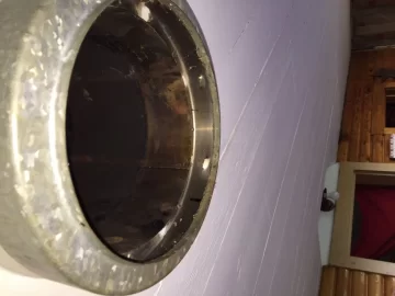

we just bought a cabin this summer and we removed the old Franklin stove. Now that winter is approaching, were thinking about replacing it with a new stove. I am wondering if I can salvage the chimney and what type of adapter I would need to go from a new stove with double wall stove pipe to this chimney. They chimney is metalbestos SS 8 inch. The double wall stove pipe would probably be 6 inch. Hoping some of you may have thoughts or suggestions. John [Hearth.com] Chimney in cabin,questions[Hearth.com] Chimney in cabin,questions
Looks like you will need a chimney pipe adapter and then a reducer.
thanks for the reply begreen. I'll look into finding those. Would Selkirk still have parts that would attach to this old chimney?
