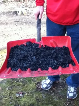

took the bottom cap off my chimney and found a lot of flakey creasote shold i sweep my chimney i have ben burning 2 year seasond norway maple thank you

Yes, that's a fair amount of black flakey sote.
It was very dry and it was in the bodem of the chimney chimney it's self saws prity clean so I don't know if I will sewers it
Lot of fuel in that shovel. I'd suspect if there was that much in the bottom there is still a good bit in the chimney itself. I'd definately recommend running the brush through it.

Ok I will but what about the thru the wall pipe from what I could see their was only a coating so should I sweep thru the wall thank you

I would definitely sweep the chimney . . . especially if this is just the stuff that fell to the bottom. This is a fair amount of creosote.
How hot are you running the stove and chimney . . . what type of chimney do you have (masonry or Class A?) . . . and when was the last time you swept the chimney?

I don't run the stove to hot because of the warm weather I have a 18ft class A flu this is my first year burning my wood is semi seasond

I guess I would respectfully ask what temp is considered "too hot" . . . seeing some numbers would help.
I would also suggest that if you need to just take the chill out of the house due to it being cool in the morning or evening with warmer temps forecast for the day I would still burn hot (or I should say burn at the proper temps), but just do a single fire, not load the firebox to the gills with your best BTU wood and then let the fire die out rather than reloading.
Of course having semi-seasoned wood can make things tough in the first year as well . . . most of us have done that, been there, wrote the book . . . continue to keep an eye on your chimney.

You are far better off running short, hot fires in the milder weather and then letting the stove go out, than burning longer, low-temp, smoldering fires. The objective is to get the keep the top of the chimney above 250F if possible. Although the thimble may look pretty clean, there is an indication that at the top of the chimney there's a lot of creosote. Inspect and/or clean the chimney before the next hot fire. Also, when replacing the cleanout cap, make sure it is sealing tightly.
