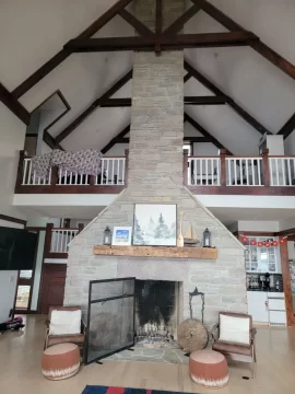

Looking at a Leyden wood stove with a blower, mainly for astetics, for our oversided fireplace. Fire box is 50in tall, 48 wide. The chimney was built in 2000, and as best as I can get a tape up the flue, is 24x24. We have 32 feet from the flue, to the top of the chimney. Its not in any walls etc.
[Hearth.com] Is Liner Mandatory for Wood Stove in Fireplace?
My question is, what function does a 6in liner serve? Its hard to get a clear answer, other than creasote built up, and chimney leaks. Neither of which concern me as I have a much larger than typical chimney. I also have the equipment to sweep the chimney each fall previous owner of the house left it all behind.
I have enough room to get the double wall pipe well into the chimney. If the chimney was sufficent for the big fires we've burned previously, what does the liner do besides provide saftey of no Co2 etc leaks? Trying to understand the "science" behind it. Someone told me it increases the draft, but a straw verus a pipe, seems counter intuitive to my uneducated brain.
I happen to own a property that was once logged for wood furniture, so have a about 200 cords of 10+ year old hemlock, oak etc that I'll be burning. I doubt we'll use it more than twice a week.
Thank you in advance for the education !!!

The cross section of the flue should match what the stove needs. A fireplace has a large opening, so a lot of air will flow, hence a large chimney is needed to exhaust that gas.
A stove has a much lower air flow, and thus needs a much smaller flue cross section.
If you empty the stove exhaust flow in a 2'x2' flue, the total speed of the gases will slow down tremendously (think about blowing in a straw, how fast that goes, and then connecting that straw to a 4" pvc pipe; you're still blowing the same amount of gas but in the pvc pipe the flow speed is much lower because the total flux (mass flow through the cross sectional area) has to be the same). That will allow the gases to cool a lot (in addition to the cooling due to an expansion when emptying in a big volume).
Cooled exhaust gases result in creosote.

What stoveliker said is absolutely all true but I will add that there most likely won't be enough heat put into the chimney by the stove to generate adequate draft to make the stove work.
BTW, nice place!
If you put a wood stove there, do you have a ceiling fan? The heat will pool at the top otherwise.
Also with a flue of 32 feet you will need one or even two flue dampers because draft is likely going to be too high.

Thank you!! MUCH better explanation then the sales guy at our 1 fireplace store in town. Appreciate the plumbing reference!
My office happens to be on that cat walk above the fireplace, so I'm good with heat going up, its where I am 90% of the time!! Plus the GFA cold air returns are actually hidden behind the trim at the bottom of the ceiling line, so if I leave the blower to the furnace on, it will suck the hot air in, and blow it out the registers in the floor. The house has 2 "wings" to it, that we rarely use, so to keep that main room 68, the side rooms are 72+. I'd just as soon keep them 60-65, and heat the main room up to 70-72. Plus I need to get rid of some of this wood we have piled around the property, so win win.
Next dumb question.......too much draft is bad? Once I drop a stainless liner down, do I still need to sweep it once a season like the fireplace, or is the service interval longer? Last one....I think.....single wall ok since its in a chimney?

Yes, too much draft is bad. It'll lead to overfiring the stove, loss of control of the fire in the stove.
And yes, generally (especially for folks starting to burn in a new-to-them stove), sweep at least once a season. You can do less if a few years of data show you don't need as much - and if your insurance is okay with that (...).

Yes to much draft can be bad. But it is much easier to deal with than too little draft. If you just ran into that chimney without a liner you would absolutely have too little draft.
Yes you will probably still need to clean once a year.
And yes just a single wall insulated liner will be fine.
Looking for something with a glass door, with a blower. The room is 30x30 with 24 foot ceilings (I know, real 1st world problems here). I can get the Leyden for 1K, with the blower. If thats not a great choice, what would people suggest?

What are the fireplace dimensions? There are many options, but it's important to know the budget too.
50" x48" HxW
Big.
Plenty of room to go larger then if desired. It's mainly up to the budget.

We stuck the stove completely in the fireplace. It needs a blower to move heat out. What ever you choose needs a blower. Might as well plan on insulating the liner. 35’ add 600$ to the liner cost of. Just guessing $1500-2500. Pre insulated is an option.
Stoves…. Drolet are good but lacking in aesthetics. Jotul F55 could rear or top vent. (Brings up the question where will the damper (s) be installed so you can easily reach them). Would stay in budget.
A Woodstock stove could look nice. Probably pushing the budget a bit.
A pacific energy T5 or big T6 could possibly work maybe even with op to a 90 (or two 45s) if you want it out in front.
You have lots of options with 50” height.
