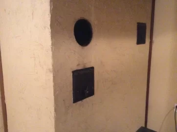

Hello, this is my first post on here and I hope ice posted in the appropriate section.
I am replacing an ancient Lakewood wood stove with a new PE summit. In doing so I'm going to put in a 6" chimney liner. I have a nearly dead on 20' masonry chimney in place (8" chimney tile with an inside dia of 6 3/4").
My first question is if it would be appropriate to use a 2 part T connection to hook up the new stove that then allows the bottom of the chimney to exit into my original clean out trap below? I guess I'm asking if it's typical to retain the clean out or is it better to eliminate it and just remove the stove for cleaning?

Thanks for that. I have had a sweep out to look at my chimney in the past and I've cleaned it out myself too. I feel that the tile chimney is compromised, joint compound has come out and it looks to me where the opening is that I put a pic of is compromised where the pipe enters the chimney. I could try to get some pics of what I'm talking about but am pretty well decided on putting a stainless liner in for safety at this point.

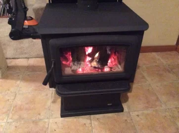

Well I didn't come back to my thread with a lot of questions but I've done a lot of reading on here, so thanks everyone for the info. I got my summit successfully installed a few days ago.
[Hearth.com] Chimney liner adapter T
Thanks again.
