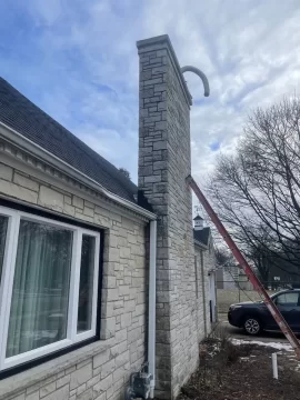

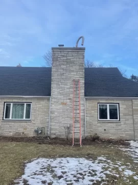

I am installing a new 5.5” stainless steel flue liner inside an old 8” stainless steel flue liner, to accommodate an update wood burning insert. The length of liner is about 18.5 feet from stove connection to clay tile top. I followed the instructions provided by the manufacturer, which were to tie a knot in a piece of rope, and then tightly duct tape it with 5 wraps around, allowing me to pull from the bottom while pushing from the top.
My house has a Cape Cod like structure, so the chimney is not accessible by the roof, making the installation tricky with limited access. The chimney is straight for the most part, however the old stainless steel liner seems to have ovalized near the bottom before it connects to a circle to oval adapter (very odd) and the vermiculite insulation may have settled in such a way causing a few slight bends.
My partner and I were able to pull the new stainless steel liner down to about 2 feet from our reach when the rope detached from the duct tape (which is about 4 feet from stove connection.) it’s stuck! Pushing, and twisting from the top is not resulting in any movement from the bottom.
Any recommendations on how to proceed?
I am hoping I do not have to remove the liner as the twists and turns make it quite difficult to move, and because it’s only two feet from my hands. Are there any suggestions on how I might be able to attach something to bottom, allowing me to pull?
Any help or recommended action is very much appreciated. I sure have got my fingers crossed!

Yeah that sucks. It's going to need to be pulled out. You may need to use a hoist to get it to move. Is it just a light wall liner?

When I installed my liner, we had a slight bend in the chimney. We were stuck there for a while, but once we rotated the liner 180 degrees it popped the rest of the way through. I know it looks like your chimney is a straight shot, but you are probably caught on a protruding flue tile or something. If I were you, I would try rotating it some from the top before pulling it back out.
Also, I had a similar setup regarding roof (although mine was not as steep as yours...) I used my eight foot ladder to get onto the roof, and the set my extension ladder on the roof leaning up against the chimney. I then ratchet-strapped the extension ladder to the chimney at the top so it wouldn't go anywhere.
Good luck!

But is it lightwall midweight or heavy wall. Whether it is salvageable or not will depend how much force it takes to get it out and what type of liner it is. Tips to avoid it in the future are pull out the 8" or figure out how to cut out the ovalized section.

That is probably light wall. It may get damaged
As a last resort try to install metal pipe from the bottom maybe in small sections if need be....and push in on side(s)..if you damage bottom you can cut and hopefully you have enough material.

Update: successfully pulled it out, luckily damage free! We tied and taped the rope to the liner at the lowest point (at the top,) raised the ladder so the top rung could serve as a pulley, guided the rope over, and pulled it out foot by foot. Had to reposition a few times, but so glad it’s out.
