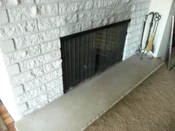

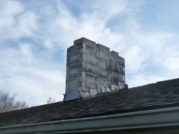

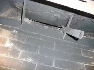

Sorry for the lack of info. I'm a novice at this as this is the first time we've purchased an insert or stove. The liner quotes were directly from the dealers of those stoves. There was no discussion of different types of liners or the respective quality of each. It was this is the cost of our liner. What Im looking for is the toyota of the liner world. I dont want junk or necessarily the "cheapest" and dont want to pay for features I dont need. But if the "cheapest" happens to get the job done for $400 less, that works for me. I want something that will get the job done and wont have to be replaced in 3 years. Here are some photos of our fireplace & chimney if that would help in making a recommendation.

Ask them about the manufacturers of the liner, personally I dislike duravent components because they are pretty light weight 26 ga, and their flashing this year only has a 3/8" lip on it.. I do like Z-flex components as well as my own MagnaFlex components... National chimney parts look good as well but I've never had them in my hands.. I would stay away from the flimsy stuff and stay with 24 gauge components.
