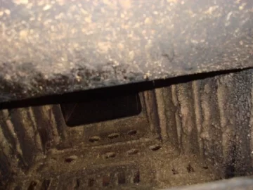

Hi guys, I have regular wood burning half circle, brick fireplace(non-insert) with a chimney that runs partially(~30%) through the inside of the house. The home is about 25 years old and when I looked inside the flu, there isn't a steel liner nor is there a flat concrete surface. It appears to be bricks that are stacked on their thin side, thus exposing the three holes of each brick. I have read that this can be considered a fire hazard because particles can be caught within these holes, which built up over time can become combustible.

doesnt look good.. thoes holes are about the worst setup you could have with brick lining.. better check into a stainless liner
Are there heat intakes and output grilles on the sides of the fireplace? I'm wondering what the slots are for below these holes.
Welcome to the forum!
Looking at the picture, I suspect they are slotted bricks, we used to get those here for internal partition walls in some houses.
They would make very good creosote traps in a chimney, and increase the possibility of chimney fires.
Not sure why they would be fitted like that in a flue on the first place.
Has anybody to your knowledge ever had a fire in the fireplace?
In any case, bricks on their side will make a very thin flue even if they had no holed/slots in them.
Just my thoughts, hope they don't sound too negative.
I reckon a new steel liner is the way to go.
Definitely. In the minimum if the intent is to keep this as a fireplace I would mortar them over. If the intent is to install an insert, than an appropriately sized stainless liner would be advisable.
If you want to keep the wood burning fireplace, a liner would do no good. The liner would stop at the bottom of the flue, what you are looking at is the smoke chamber. Behind the holes in the brick you will find either more bricks or most likely concrete block. The bricks in the smoke chamber should be parged smooth, filling the holes and smoothing out the smoke chamber which improves draft and decreases the build-up of creosote. Check this product out. http://www.chambertech2000.com/

Your smoke chamber looks to be in good shape. you don't need a stainless liner, you have a clay liner currently. If you don't like the cores of the brick showing, parge it with mortar.
