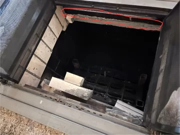

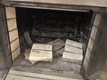

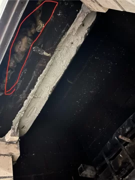

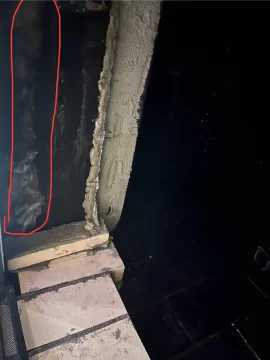

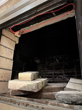

Here are some pictures from various angles. I’ve tried to circle in red the area that has exposed wood, although there is also some rock wool insulation tucked in front of it.

Could you clarify what you mean? Do you mean that the wooden piece will still catch on fire?
The reason I don’t think that area would get extremely hot is because it wouldn’t be directly exposed to continuous flames, since it is at the very front. Before somebody’s “renovation”, this part would have been on the outside of the surround but they extended it out by a few inches to add a new surround on top of the old and a new frame.
Yes it is well within the area that needs to be completely non combustible. The wood needs to be removed
