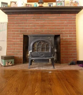

Now that I'm in possession of a stove (a great craigslist find - blue/black enamel Jotul F3), it's time to fine-tune the rest of my installation. I need to line the chimney, and I've got exactly 17 ft. from fireplace floor to top of masonry. Centerline of the flue outlet, rear-vented, is 22.5" up - add 3" for pipe diameter and that puts me at 25.5", leaving me with 14' 10.5" to the top of masonry. I'm not sure, but it seems like a 15' liner would maybe be a tad bit short...but then again, does the tee add a couple inches vertical, and is 2 or 3 inches enough at the top to secure the cap? Getting a 20' liner isn't that much more expensive, but I'd hate to cut 5' off of it when I might just have a perfect setup. Advice?
And the obligatory stove pic.
