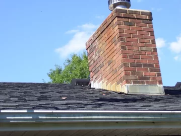

Just had some company come out to give me a estimate on repairing my chimney as there are some cracks in the crown and some spalling. They tell me that there are spider cracks all down the chimney and it needs to be completely repaired with a new crown. Any idea of what I should expect as far as an estimate? It is on a ranch house. Here are a few pictures from the ground. I do not do heights very well....... [Hearth.com] Chimney needs repaired...ouch

I've seen a lot worse.
Yes there's some spalling in the back and I'm sure there's spider cracks but it's really not that bad.
Get a second opinion. If funds are tight that chimney could be easily patched up and then waterproofed.
Without a doubt the best scenario is always a rebuild. Patching only lasts so long before the weather chews it up again.
The question becomes do a rebuild now or patch it for another ten years if lucky and do the rebuild then.
A good application of waterproofing will help greatly in keeping it together. They make some really good expensive epoxy type waterproofers. You can also just go with the cheap thompsons water seal and soak that thing heavy and repeatedly.
Back in the day Id charge you about 800- 900 bucks,,,,cash to do that full rebuild including new lead flashing. That was back in the day,,,,,,for cash. I would hope someone would be willing to do it today for $1200 or less.

Wow, I was thinking in the 5,000.00-6,000.00 range. If I was to patch it , would I use something like regular mortar with a heavy dose of breathable water sealer? What about the cracks on the crown? Same deal with mortar or some type of caulk?

I would say under $2000 i think $120 is a little low if he is going to pour a crown and rebuild from the roof line up. But absolutely do not use thompsons it will make the problem worse. I typically don't like using sealers they are a band aid that just attempt to cover up the real problem but if you do use something especially designed for exterior masonry. But if you have spalling brick i think its to late for sealer. I would cut out the bad brick repoint and do a crown. It doesn't really look like a complete rebuild

Well if you ask around enough I'm sure you'll find somebody willing to charge you that much lol. And yes I worked cheap but it kept me busy.
Any good Mason will have a yard of new leftover bricks and mortar accumulated from bigger jobs. Technically these bricks are already paid for ;) Sure we figure that stuff into the price but just how much money does one need to make in a day to make it worth their while to get out of bed.
Your crown seems quite minimal. That's me being nice. Very difficult to find a mason who pays enough attention to hand troweling a crown to its proper dimensions. It can be done correctly without building a form but it takes the will and expierience to learn how it's done.
It's also not a question I can truthfully answer from a photograph. Yes your crown is lacking in thickness but is chopping it off causing more damage to the chimney than it's worth? Can't really tell from a photo.
With a thin crown that's still relatively solid sometimes the best method is chisel it back from the edges and re crown over it correctly.

He did mention he would build a form for the crown and extending over the chimney a little so it drips down instead of back into the seam.
That is typically what we do wit ha bond break between the new and old crown and around the liners. Yeah 5 to 6 thousand is way to much but i would not go cheap either the cheap option is often not a very good one and you will be paying to redo it later.
Good that is the way it should be done.

Well, received the estimate.----$3,200.00. Plus an additional $800.00 if I want them to replace the flashing....
