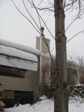

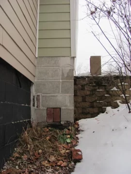

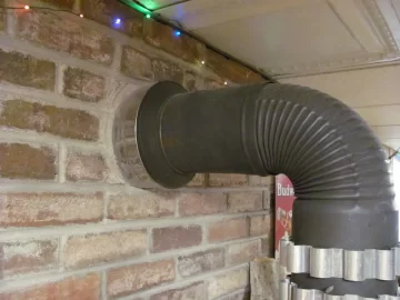

If you use double walled insulatated stainles you can do it. Here is my set up. Goes out basement wall here, convert from regular stove pipe to double wall insulated stainless. Then using a "T" agsin Double wall stainless, go up . Need to have a place for a clean out, hence the T .

Where/what are you talking about ? The horizontal into the 90 is on the wrong side but going down the 90 is inside the pipe out of the stove.
The black single wall pipe, male end gets pointed towards the stove, this allows and liquid creosote and finer flakes to fall back into the stove rather then leak out of the pipe.
Ya I know that but I had to cut this per SBI's recommendation and it's all I had to work with at this time It will get me through the winter. No creosote drippage yet.
The galvanized corrugated looking pieces around the black pipe.
Pretty sure that’s Heat fab pipe, not SBI. I really like SBI single wall. We rarely ever install single wall anymore. Probably 1 in 20 installs these days.
Oh, those things. They just wrap arounf the stove pipe and clip together. They are just a heat sink/cooling fins. It's single wall welded stove pipe. Heavy gauge. Not sure what guage any more now.
