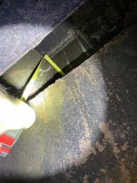

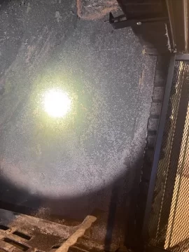

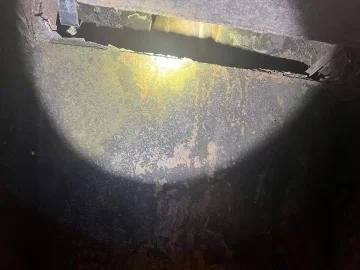

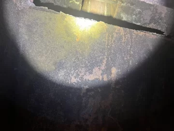

Hi all, I bought a house about a year and a half ago and when we bought the house we were told the chimney was too “rotted” and not safe to use. I know nothing about masonry or chimneys but am mechanically inclined - mechanic and machinist by trade-
my original plan was to have it repaired, had a chimney guy come out and he said that would be a significant amount of money better option is to wood stove and pipe it out existing chimney which he said was in OK shape.
I wanted to do an insert to have it recessed in as we have the raised hearth as seen in attached pictures. I went to the stove shop and he seemed to think that wasn’t possible and wanted to have another guy look at it. I’m trying to avoid spending that extra money so I’m looking to get some advice from the real geniuses… the internet.
So my questions are, is it possible to just cut out This metal insert and recess in then wood insert and then do 6” pipe out the flue? What is the next best option if not possible. Thank you.

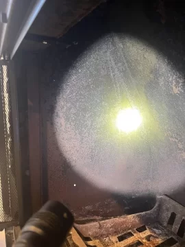

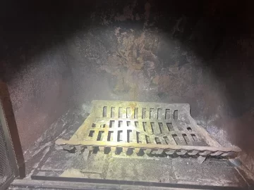

It looks like this may be a heatform style fireplace. The installation is not up to code due to the lack of any hearth in front of the fireplace. An insert may be installed with an insulated liner up the chimney. There doesn't appear to be enough depth to recess an insert there. The best option may be a flush unit. It will need hearth protection per the insert's manual.

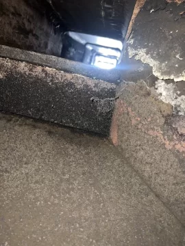

With a heat form style is it not possible to cut out that metal box to give myself more clearance for dropping the liner in?
You typically cut out enough in the damper area to allow the liner to pass through

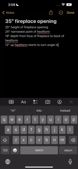

What are the fireplace dimensions? front and back and depth? Will it be used for 24/7 heating or more for ambiance fires on nights and weekends?

Sorry for the late reply BG, I really appreciate your help so hopefully you find this reply.
Attached is the measurements I took hopefully I worded it enough to make sense. I’m not really sure what I’m talking about.

As an owner of a US Stove product I would highly recommend looking for a different unit even if slightly hire priced. US stove quality and performance has a lot to be desired, I would suggest looking into Drolet or century heat both competitively priced and available packaged with a liner.
This looks like it would fit. The minimum installation requirements according to US Stove are:
Minimum Width 29”
Minimum Height 23”
Minimum Depth 14”

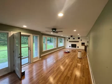

Is this the only room being heated with the insert? How large is it?

Yes it will only heat my living room with some heat lingering to my kitchen which is right next to it.
Just under 1200sqft combined. I will look into the drolet and century’s.

The Drolet 1500i is the right size for that space, but finding one may be a big challenge. Stove inventory is very low. Check with these folks and ask for Sean.
