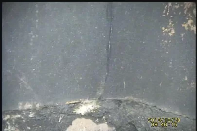

Hey, new to the forum here and looking for some help. I bought a house (built in 86) and had a chimney guy come out and clean and inspect it. he said i would need a new chimney liner. well he gave me a quote for $7,400... They would need to knock out the clay liner and put in a steel liner and surround it with vermiculite. the issues he found were some vertical cracks in the clay liner and some black builup around the bottom third of the chimney which he said was from a smaller chimney fire (smoldering type). the pictures he gave me with the quote showed the cracks, but they were very thin and short hairline cracks. there were no gaps in the cracks. i had a concrete guy out doing some other work for me (he also does chimney replacements) and he said the guy was probably hard up for work. him and i went up and looked down the chimney and he said it looks perfectly fine. he said you will inevidibly get some cracks in the liner and it would be fine to use. If anyone has any insight they could give me i would greatly appreciate it. I attached a few pics he had of them. Thanks again!
Chimney:
Flue liner 9x18 OD
7x16 ID
chimney 24 feet

Depending on which stove u get, I would still throw 6 inch flexible liner in and call it good. Insulate only if the chimney is on an external wall.
The quote you were given is a bit too high for the work he wants to do, and it seems unnecessary. If the clay liner was in such bad shape that the cracked pieces were falling into the chimney that would be cause for more concern. My thoughts are installing a insulated SS liner. The clay liner will now have protection of a top cover and no further fireplace use. I'm not sure vermiculite is necessary if you blanket line it.
I had a SS liner put inside my clay liner. The guy that did it did not need to knock out the clay and the cost was less than a quarter of what you are being charged.
the first guy is 100% right per-code once the chimney liner is cracked it needs to be fixed. The first guy is also on the high end of the pricing. shop around for some more quotes a wrapped insulation tends to be less then a poured my be a good way to go.
Thanks for the replies so far. I should note that the chimney is for a wood burning fireplace and the chimney is on the external wall. the quote referenced the code on the liner, but it is not very clear on the severity. it just states that if it compromises the integrity of the liner. i would think that those small cracks would not compromise it, especially since there is another brick and mortar layer surrounding the liner.
i am a very handy person and have done most of the remodel work on the house myself. Is dropping in a new liner something i could do myself? the only issue i think i would run into is sealing up the liner at the bottom of the chimney. i think if i got a rectangular insulated liner i could still just about get the right ratio for liner to fireplace size.
The ID of the chimney is gonna be an issue. Seven inches is not wide enough for dropping an insulation wrapped six inch liner down it. And it needs to be insulated. Integrity of the chimney isn't the issue with those cracks, but heat getting through them to the combustible surrounding structure members is. Gotta insulate the liner.
Pre-insulated rigid liner or flex liner is available and will fit. It ain't cheap but it ain't seven grand either. And since I am the least skilled person on the planet and have lined three chimneys you can do it. Just don't go falling off the roof.
Tell us all ya can about that chimney and what you are gonna be doing with it. Open fireplace, wood stove or what? Open fireplace will complicate the lining issue.

I have video of Hogwildz and I doing the 6" liner in my chimney 24' up. My masonry liner also had significant cracking. But yes, small cracks can and do compromise the liner. Heat and pressure do amazing things.
Yes, a liner can be done DIY, but I'd recommend against "by yourself." Check YouTube- there are TONS of videos of folks putting in steel liners. I think Rockford even has a video section on their website. Our crew was me, Hogwildz, Mrs. Blue, and the dog. Of those, I was only helpful in paying for the kit, making chili, and rescuing Hogz off the roof when the lift broke.
Relining that flue will be very expensive! It will need a heavy rectangular flex liner and they are high! But, $7400! That's too high for sure.
You would be money ahead to install a fireplace insert and a 6" round liner. It would heat your house, have a pretty fire, and come in cheaper than your original bid.

I suggest that you forget about using your fireplace as a open fireplace and install either a wood-burning insert or a free standing woodstove in the fireplace opening. Having had one, trying to use my open fireplace as a heat generating device was a loosing proposition. And if you want to use your chimney to exhaust your open fireplace, you should repair the terra-cotta flue.
On the other hand, if you install either an insert or a woodstove, you can slide an insulated flex liner down your existing flue w/o removing/repair the terra-cotta flue. In my view - just my opinion - the photos that you posted showed that the flue is not in bad shape.

Again if you want an insert and can install an insulated stainless steel liner through the current clay liner and the current literally only has a few cracks in it there should be no need to remove the current clay liner so long as you can fit an insulated liner in there (maybe 5.5inch). Obviously there are those with more knowledge but again that is extremely expensive.
If you could just fit a new liner in the current flue we are talking ~700-800 dollars for a kit. And If you pay someone to do it (license and insured) we are talking maybe another 400-700 for install.
I would think your current clay liner would have to be in much worse shape for it to have to be completely gutted like that.
