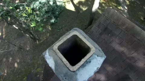

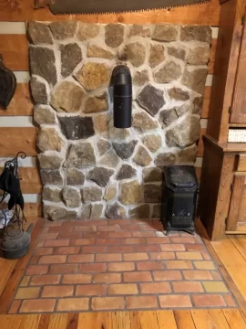

I am running into a size dilemma. I have a US Stove Magnolia 2500 wood stove that requires a 6" stove pipe.
The log cabin we purchased ( built in 1994) has a field stone chimney that is lined with 8"x8" terracotta Clay. The inside diameter of the chimney is 6-3/4". The flex chimney liner is 6-1/2" outside diameter. If I use the insulation blanket that adds another 3/4" total. That pushes the size to 7" too large to fit. My questions are do I just use the liner with out insulation and take the chance of a poor draft, down size the liner size to 5.5" or just use the chimney without a liner?. I have not had the chimney inspected yet but it looks very clean inside. Previous owners had a antique Quality gas stove converted to propane hooked up.
Please any suggestion's would be greatly appreciated. Thank you, Mike

Remove the clay liners you will have plenty of room. Also you need to check the wall passthrough. Unless that is a full masonry wall chances are combustibles are to close.
Removing the clay liners would destroy the chimney I would think. The wall is solid masonry. Thanks
No it doesnt we remove them all the time. Is this in the basement? Or does that stone go all the way through the logs to outside?

@bholler is a certified professional installer, perhaps more pics of the chimney is needed (including the clean out) inside pics from the bottom up with a cell phone and powerful flash light.

This is all on main story and goes through the wall without a cleanout
Yes but does the stone go through the wall or is it log on the outside in that area?
It goes through the wall. A wood frame surrounds the stone. The chimney base looks like cinder blocks with field stone mortared to it.
Thanks all!
Ok then the pass through should be good

I would shovel it out the crock. You wouldnt take it up and out. Do you have the required 1" of clearance between the outside of the chimney and combustible materials? If not you need insulation.
A 6" liner without insulation will fit in my 8"x8" flue. Tight but will fit. I just did not know that if I could not use insulation wrap would that cause a poor draft performance.
It may cause poor draft. The biggest issue is the safety factor. Do you have that 1" of clearance between the outside of the masonry of the chimney and combustible materials?
And honestly if your clay is 6.75 inside the chances of getting even a bare liner down it are very slim. Even the slightest offset in the liner will keep the liner from going down.
