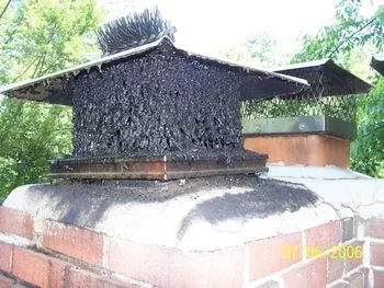

Me either. I get a little soot out of my chimneys but the caps always have a lot of large flake in them. It can't help but happen given the temperature differential up there outside of the chimney. And until I changed out my caps a few weeks ago mine have never had screens in them. I hope this isn't what I am in for:

BB I don't think you could get your cap to look like that if you tried, unless maybe you cut down some fresh trees and split them up and burnt them in your stove 2 weeks later.

that chimney is what we in the industry call " a sweeps delight!".. its sounds like a slot machine hittin tripple 7s falling down into the cleanout with all the falling soot...
Holy crap!
