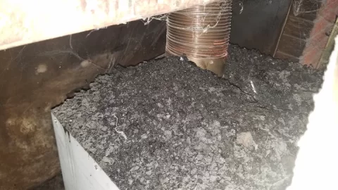

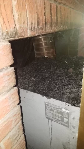

This post is a follow up from an earlier thread I posted regarding a terrible wood smoke smell coming from my PE summit insert. I was at a loss so I called a professional. I described the problem to him and he seemed to gravitate towards something in particular. He pulled the stove out and this is what we found. Years of creosote on top of the stove. He figures the previous homeowners had either installed this as a slammer with no liner, or never cleaned the masonry chimney before installing the liner. He inspected the chimney and said that it looks like all the creosote had fallen and none remained.
Hopefully this resolves the problem. I told him it was a sour smoke smell, which he said is the creosote heating up. Fingers crossed, it's better now. Can't build a fire today or tomorrow but hopefully Thursday I'll test it out.

Wut.
So what happened when the liner was installed? They didn't sweep the chimney before installation? They left that big pile of crud on the stove after screwing in the liner?
Both? ;sick
Reactions: SpaceBus
Wowzers. Consider yourself lucky. Creosote generally ignites when it reaches 451 degrees and stove top temps can easily go north of that. What probably saved you is the fact this was an insert which turns a lot of the heat into convective heat so the outer jacket has a harder time getting that hot.
I guess the OP needed a diaper change when he saw that.
We say that at work all the time, or "I got you a dirty diaper" meaning a bad job is coming, or "I'm sitting in a lot of squishy stuff" means current job is starting to turn for the bad.
Wow - that seems like a ridiculously large amount of creosote to just have been 'in' the chimney. I guess it's possible, but also be sure the sweep checked the current liner. Make sure you don't have a leaky or broken liner joint putting more and more smoke / creosote into the old chimney.
Did the sweep scan the liner to make sure it is ok? Did he check and clean the smoke shelf? Is the liner insulated?
Yes, an interesting find indeed. He did look over the liner from the bottom and didn't think it was compromised. It's a single wall non insulated liner. Kenny, I too am in that line of work and I know exactly what you mean!
Simply looking at it from the bottom would not be enough for me
It's 15 degrees out and there's about 15" of snow on the tin roof. It's not safe to go up there now.
