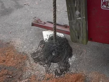

And there is this.
  • [Hearth.com] Chimney sweeping with a rock in a sock

I've read about using chicken wire to clean out masonry chimneys in fireplaces. You crush a piece of the wire mesh up to about the size of the flue and run it up and down with a rope...can put some weight into the ball of crushed wire to help. Haven't tried it, but no reason it would not work just fine. Cost=nothing for a piece of old scrap chicken wire.
