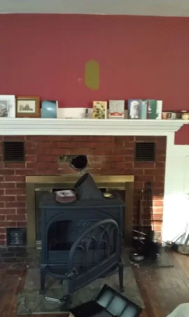

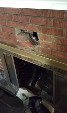

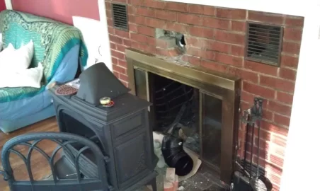

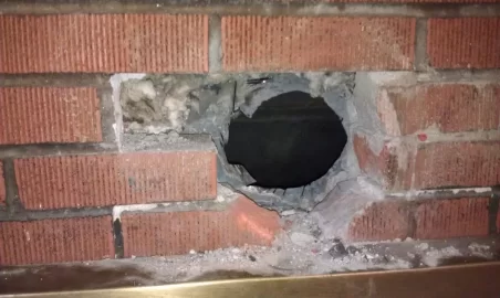

Hmm, never thought of putting up pictures. Here're a few snapshots of the project/predicament:

What about a torch to cut away that heatalator?
FirewoodMan said:
I'd keep hacking away at that hole and the box behind. I think a higher thimble that's above your mantel would look pretty bad.
I agree, just remember that a quick fix is gonna be something you have to look at all the time when you get this project done, so do it right the first time and mum will stay happier too.....you should really really consider that steel liner, takes a lot of headaches and worries away, and that stove will perform to it's peak with the proper flue.....you will have way too much space with the existing flue for that stove to operate correctly, it will take all you got to heat that flue up.....with a stainless insulated flue it will be way more efficient......just my 2 cents....
just wondering about the price quote.....was the "professional" thinking he was going to get the install? maybe he was trying to drum up some business.
cass
Ah now we can see. So you too have a hearth mount. What i did was run into the fireplace to a T which connects to the stainless liner. Nice and easy to clean, plus good on the eyes. If you keep going with the route your doing, you can cut that stuff. A torch is best, i used a sawzall and a few blades and swearing.

Well, in your shoes, I would look to try and enlarge your existing hole/flue by whatever means you can before I'd try and patch that existing hole to move it higher. (Problems foreseen: matching the brick/mortar and who knows if further up you might have the same problem, right?) If there is a damper throat plate that can be chiseled out and extracted, that might give you some clearance. You can always cover the resulting gap at the flue throat below with a block-off plate.
If you wanted a third option, you could cut the existing brick lintel and move the whole fireplace opening up to above the existing thimble hole. Of course, you'd have to replace the lintel with another one to bear the load, and it might be above the top of the existing fire bricks, which might be uuuu-gly. Still, it would allow you to clear out all the unecessary crap and make a nice opening for your connector/liner. Just sayin'.
Surely you weren't to code before when you had the pipe entering so close to the mantel? Anybody confirm this. Isn't it 18" to combustibles above black pipe?

The mason's been here for the last three hours, and the job's nearly done. We decided to go with expanding the existing thimble rather than putting in a new thimble above the mantle. He's busted through the heat-a-lator metal wrap, taken out the damper, put 10ft of flexible liner up the flue (money's tight, and I got it for free), and he's now re-bricking up the fireplace front. Thanks for all of the advice -- I'll put up more pictures when it's done!
