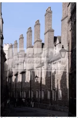

It is a somewhat arbitrary MINIMUM which may give decent results if everything else is in order.
But when it comes to solid fuel - you only have to look at proper chimneys in Britain and Europe to see that they often have to be higher than this....for proper results. Sometimes it is draft, sometimes it is keeping smoke from your neighbors windows, etc.
