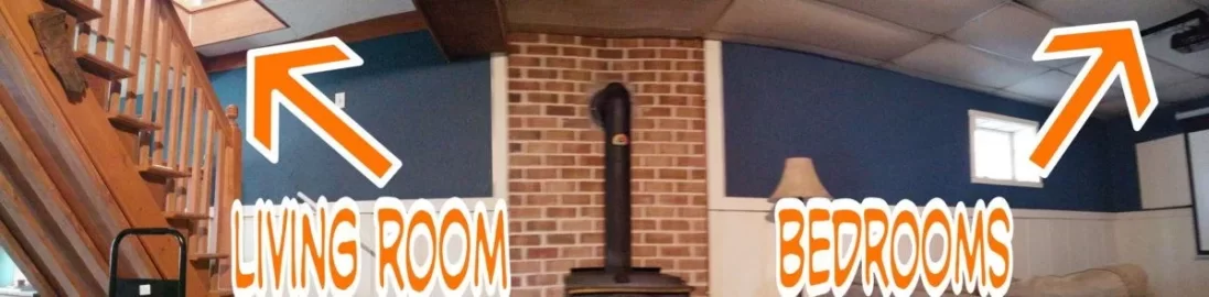

I've been trying to figure out the most efficient way to distribute heat from my wood stove around the house.
The stove is in the basement and right by an open staircase that comes up to the living room. The two problems I have are getting the heat back the hall to the bedrooms and having the basement get uncomfortably hot. I'm used to it but company is not. I figured I could help to minimize both of these issues by putting a fan in the floor of the bedroom. In theory this would blow cool air into the basement and create negative pressure in the bedroom to pull heat back the hall.
Anyone have any thoughts as to how effective this would actually be before I destroy my floor. And why kind of fan would you recommend?

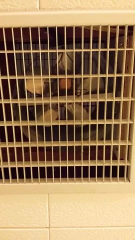

I have a fan in my floor going up, Works very well! 3000sq/ft and have not turned my furnace on for 3 years except when we leave town. With it off I can store heat in the basement for a nice duration of time as well. Heat still pumps up through my stairs as well.
The fan is nice and quiet as it only needs to be on a low speed.....

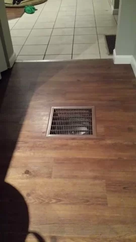

couple pics of the fan that is in my floor. keep in mind that if you are nervous about house fires, this provides another route for fire to spread to the upstairs quickly.
That's what fusible-link dampers are for.
Reactions: BigFir
Huh..... I see these all over my work place (on a bigger scale) and it had never dawned on me to get one for this fan! Thanks Begreen!
