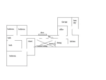

Here is a not to scale house drawing. The fan in the hallway near the front door and insert sends a good amount of heat into the office, dining room, kitchen, and even down the hall to the laundry room. Using another fan I have been unable to get much heat towards the side where the bedrooms are. The doorway between the front hall and wing with the bedrooms is small where as the hallway going towards the office is much larger and more open. It actually seems that when I have a fan blowing into that hall the air leaving those rooms blocks the warm air I am trying to blow down there. The turns keep any air from getting into any of the bedrooms. Thanks for any ideas!

Marcus, it looks like you have a problem since you're trying to direct air in two directions. If you have a fan at either end of the hallway then the air can only go one way. I would try an oscillating fan on the wall opposite the door and see if you can get some air circulating with it.
Its going to be tough getting heat to those far away bedrooms. Remember wood stoves are space heaters not whole house heaters unless you have a open floor plan. Have you tried putting a box fan on the floor near the beroom/ bathroom area blowing toward the stove?
Oscillating fan in the hallway won't work because there is not enough room. I found that while the one wing is staying warm, there is a river of air flowing from the other wing towards the insert. The flow of air is at ground level and also all the way up to the ceiling, so warmer and colder air are both being sucked out of the bedrooms. I'm going to try keeping the doors closed for a day and the fan on the floor blowing towards the insert.
